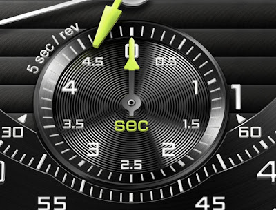

Inside the MIKROTIMER Flying 1000
TAG Heuer has broadened its research into what is known as spiral-based regulating systems. The result is an escapement developed together with Atokalpa and vibrating at the mind-blowing speed of 3,600,000 beats-per-hour — more than 3 times faster than the pistons of an F1 engine cranked to maximum speed. The speed and high-frequency of the MIKROTIMER are mind-blowing- 500hz beating at 3.6 million beats per hour- 10 times faster than the MIKROGRAPH and 100-times faster than an El Primero. And that means that the central chrono hand completes a full rotation 10-times every second.
The flying central hand of the MIKROTIMER Flying 1000 makes an astounding 10 rotations per second, indicating 1/1000th of a second and 1/100th of a second on a scale on the external part of the dial, which has 100 graduations over 360°. A second, smaller central hand indicates minutes (TAG Heuer Patent pending) and 1/12th of a minute on a 150-second scale. A counter at 6 o'clock displays 1/10th of a second, calibrated to 5 seconds.
At a glance reading
This unique dial-scale display system allows direct, instantaneous reading of minutes, seconds and 1/1,000th, making this the only mechanical chronograph for sporting events like the Formula 1, where 1,000-of-a-second accuracy is essential. It puts the MIKROTIMER Flying 1000 right up there among the most intricate “Grande Complication” ever developed in mechanical watchmaking.
