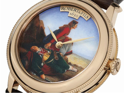

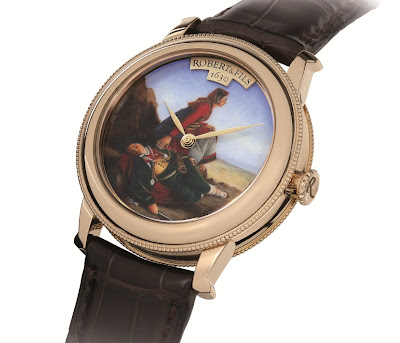

Case and dial in gold, grand feu enamel, inspired by “Brigand’s wife watching over the rest of her husband”, on display at the Museum of Fine Arts in La Chaux-de-Fonds (Léopold Robert, oil on canvas, Rome 1827).
Deposit from Fondation Gottfried Keller, 1964. “Five step” historic automatic movement, produced at the Fontainemelon manufacture between 1960 and 1970. Oscillating weight in 22K gold. As for price, there's not much change left from $100k, – US$95,123. The piece was originally displayed at Baselworld earlier this year.
